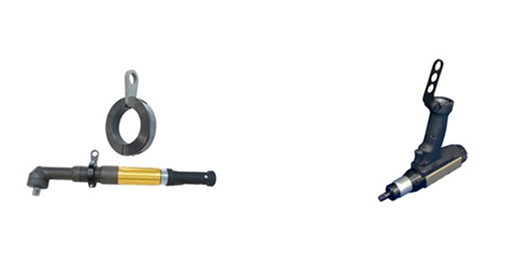

HAND HELD Suspension
The Hand Held Nutrunners are very versatile for assembly. It is critical these tools can be suspended and out of the way to let operators add value to the process. This selection of suspension accessories are designed for the tools, ensuring that the tools are clamped in the proper place to maximize the life.
| Component | Model | Description | Recommended Tool(s) | Key Dimensions | 2-D Print (pdf) |
2-D Drawing (dxf) |
| Hanging Hook (φ40) | HFA-TF01 | Fixed, clamp style tool suspension | Angle tools 60Nm and under | 40mm diameter | HFA-TF01.pdf | HFA-TF01.dxf |
| Hanger Arm (φ52) | HFA-TF04 | Fixed, clamp style balanced tool suspension | Angle tools 60Nm and under | 40mm diameter | HFA-TF04.pdf | HFA-TF04.dxf |
| Hanging Hook Grip End | HFA-TF06 | Fixed, cable end tool suspension | All HFT straight and angle tools | 40mm diameter | HFA-TF06.pdf | HFA-TF06.dxf |
| Hanging Hook Grip End (L type) | HFA-TF07 | Fixed, cable end tool suspension – vertical | All HFT straight and angle tools | 40mm diameter | HFA-TF07.pdf | HFA-TF07.dxf |
| Hanging Hook (for Pistol tool) | HFA-TF08 | Fixed, pistol tool body suspension | All HFT pistol grip tools except: HFT-035M80-P1-X13001 |
40mm wide | HFA-TF08.pdf | HFA-TF08.dxf |
| Hanger Arm (for Pistol tool) | HFA-TF09 | Fixed, pistol tool handle suspension | All HFT pistol grip tools except: HFT-035M80-P1-X13001 |
N/A | HFA-TF09.pdf | HFA-TF09.dxf |
| Hanging Hook (Rotary type) | HFA-TF10 | Rotating, clamp style tool suspension | All HFT straight and angle tools HFT-xxx-M80-x-xx | 48mm diameter | HFA-TF10.pdf | HFA-TF10.dxf |
| Hanging Hook (φ47) | HFA-TF12 | Fixed, clamp style tool suspension | HFT straight tools 55 – 130Nm HFT angle tools 80 – 200Nm |
47mm diameter | HFA-TF12.pdf | HFA-TF12.dxf |
| Hanging Hook (φ58) | HFA-TF13 | Fixed, clamp style tool suspension | HFT-300M120-A-20 | 58mm diameter | HFA-TF13.pdf | HFA-TF13.dxf |

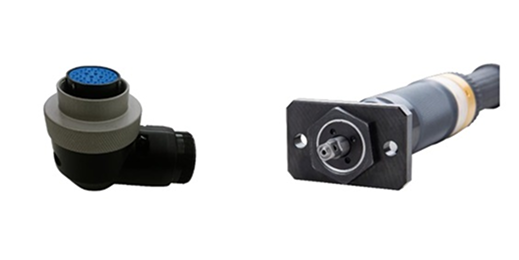

HAND HELD Additional Accessories
The Hand Held Nutrunner product line is ever expanding, below are some accessories to improve the ergonomics and functionality of the line. Additional accessories and customization is available upon request.
2-D Drawing (dxf) |
| Torque Reaction Plate (Hex41) | HFA-RP01 | Straight tool mounting plate | Straight tools 40Nm and under | (x2) 9mm clearance holes 60mm apart | HFA-RP01.pdf | HFA-RP01.dxf |
| Extra Handle (for Straight tool) | HFA-HA01 | Front mount handle for straight tools | Straight tools 40Nm and under | N/A | HFA-HA01.pdf | HFA-HA01.dxf |
| Extra Handle (φ32.5) | HFA-HA02 | Front mount handle for pistol grip tools | HFT-015M50-P1 | 32.5mm diameter | HFA-HA02.pdf | HFA-HA02.dxf |
| Extra Handle (φ35) | HFA-HA03 | Front mount handle for pistol grip tools | HFT-035M80-P1 | 35mm diameter | HFA-HA03.pdf | HFA-HA03.dxf |
| 90 Degree Connector Adapter | HFA-LC01 | 90 degree elbow for cable connection | All HFT hand tools | Offered in 90 degree increments | HFA-LC01.pdf | HFA-LC01.dxf |
