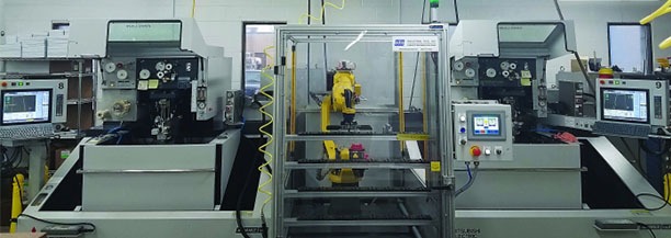

To better serve customers, Twin City EDM determined that integrating a robot into wire EDM processes would be ideal for large production orders and the best investment would be a dual-wire EDM automation cell to pair two Mitsubishi MV1200 wire EDMs with a FANUC six-axis robot for part handling.
Although plenty of different machine tools lend themselves to some form of automation — Lindell said Twin City EDM has two robots for its sinker EDM side and automation for the milling machines that produce electrodes for those EDMs — it’s rare to find a wire EDM with automation. That’s mainly because wire EDMing often creates a slug, or leftover piece from the raw material, that needs to be manually removed from the part.
Twin City EDM purchased the new wire EDMs from Elk Grove Village, Illinois-based MC Machinery Systems Inc., a subsidiary of Mitsubishi Corp., and enlisted the services of Minneapolis-based Industrial Tool Inc., an automation robotics integrator for machine tools. ITI was able to do most of the legwork at its own facility, thus eliminating any shop disruption for Twin City EDM.
