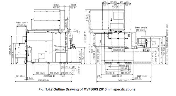

| Machine Travels: X x Y x Z in | 31.5 x 23.6 x 31.89 |
| Maximum Workpiece Dimensions: W x D x H (in) | 49.2 x 40.2 x 31.69 |
| Max. Submerged Workpiece Weight: lb (kg) | 6600 (3000) |
| Table Dimensions: in (mm) | 42.5 x 34.3 (1080 x 870) w Back Rail |
| U/V Travels (from center): in (mm) | ±4.0 x ±4.0 (±100 x ±100) |
| Taper Angle @ Thickness: in (mm) | 15 deg.@ 14.3 (15 deg.@ 365) |
| Wide Angle Taper (Optional Guides Required) | 45 deg. @ 3.2″ (No AT Possible) |
| Table Rapid Feed Speed: in/min (mm/min) | 51.2 (1300) |
| Power Supply | V350-V |
| Minimum Drive Unit / Resolution | 0.00001 / 2 millionths (0.0001 / 0.05µm) |
| User Program Storage [Hard Disk Size] | 1 GB [80 GB] |
| Wire Diameter Possible: in (mm) | 0.006~0.012 (0.15~0.3) |
| Minimum Start Hole Diameter: in (mm) | 0.02 (0.5) |
| Max. Wire Spool size On Machine / Built-in Box: lb (kg) | 22 / 55 (10 / 25) |
| Filters / Type | 4 / Paper |
| Filter Tank Capacity: gal (L) | 391 (1480) |
| Machine System Dimensions: in | 134.2 x 139.6 |
| Machine Installed Height: in | 134.5 |
| Machine System Weight: lb | 14,806 |
| Fluid System Weight: lb (kg) | 990 (450) |
| Power Requirements [KVA] | 200-230V [13.5] Built in AVR |
| Compressed Air Requirements | 2.7 cu.ft./min. @ 71~100 psi |
