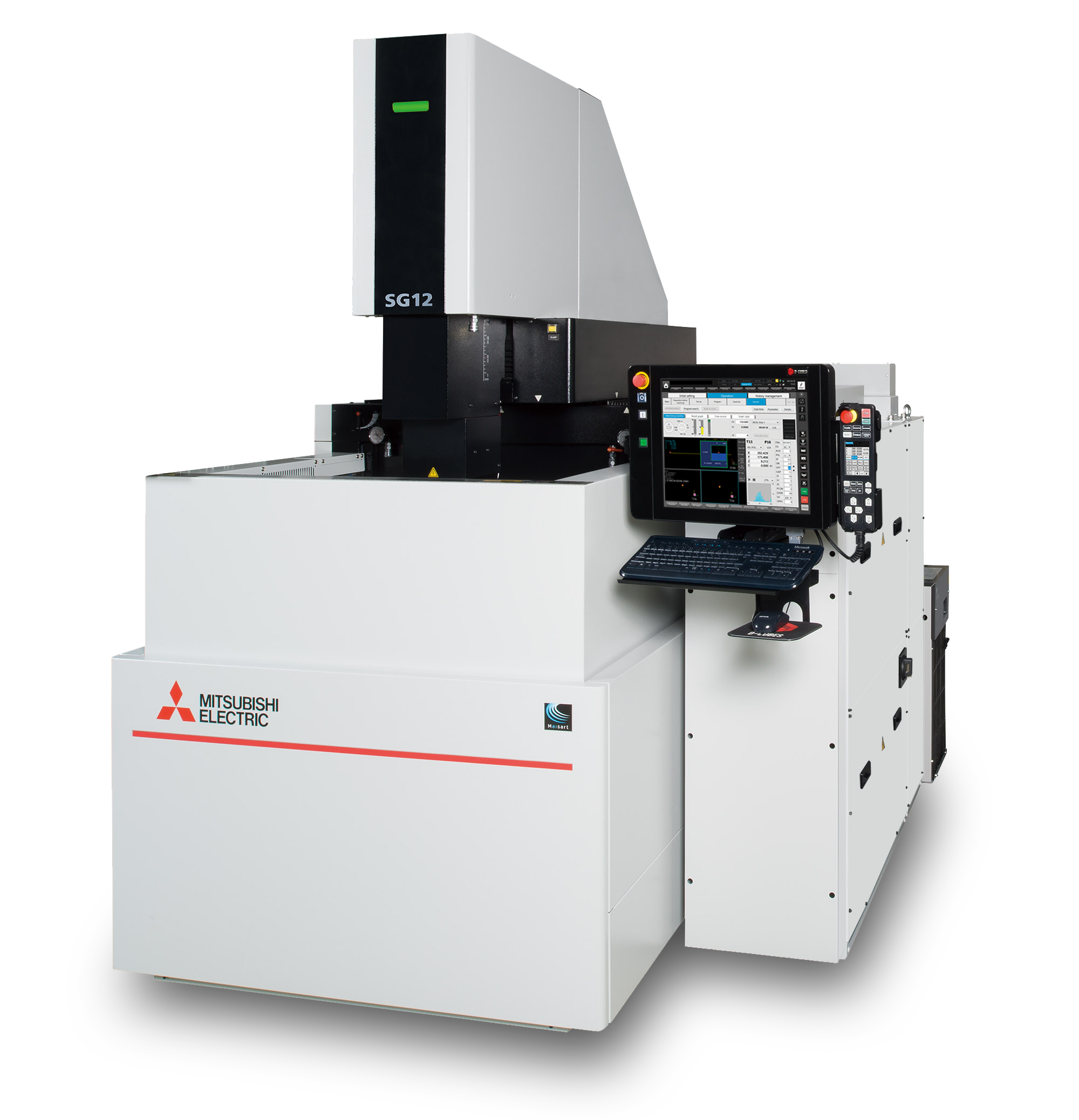

What is Sinker EDM?
Sinker EDM, which is also called ram EDM, volume EDM and cavity EDM, is a type of EDM used to produce cavities in metal workpieces. This is done using an electrode tool that is the shape of the cavity being created. The shaping tool, or die, can be machined to create complex positive shapes that are then used to erode materials from the workpiece to create the cavity. These tools are generally made out of materials like graphite, tungsten and copper.
For sinker EDM, the electrode and workpiece are immersed in insulating fluid and linked with a power supply. The workpiece and electrode must be alternatively positively or negatively charged. As the electrode approaches the workpiece, an electric spark forms between them at a temperature between 14,400°F (8,000°C) and 21,600°F (12,000°C), vaporizing the metal in the localized region. The electrode does not cut entirely through the metal, but instead cuts out the cavity with no material stress. Sinker EDM can create intricately shaped cavities that can be used as injection molds and stamping dies.
