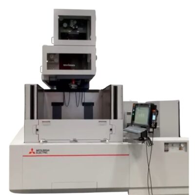

The new Mitsubishi MV4800-ST wire EDM can perform submerged machining up to 32 inches, making it an excellent solution for large-part applications in industries including aerospace and energy.
Features include an advanced thermal stability system, automatic fluid-level control, Mitsubishi’s advanced auto-threading system, an ergonomic design, and the user-friendly Mitsubishi CNC control with 19-inch touchscreen.
The MV4800-ST, which stands over 11 feet tall and more than 11 feet wide, also has new Mitsubishi Electric technology, including:
