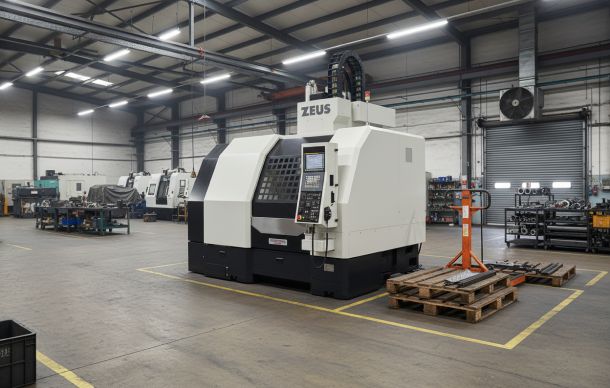

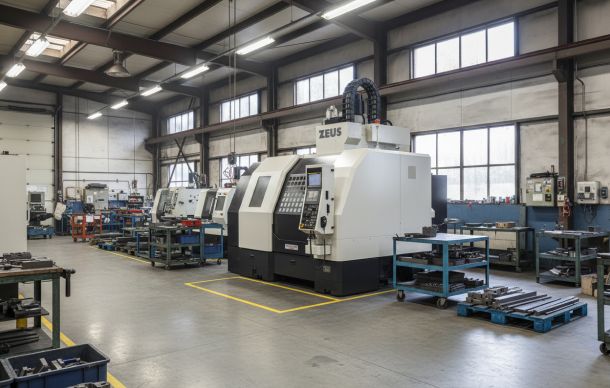

ZEUS-86
ZEUS-86
Roku-Roku’s most powerful and largest high-accuracy machine, built for shops that need to mill large workpieces (up to 1,763 lbs.) without compromising precision. The ZEUS-86 features a bridge-type monoblock structure with twin ball screws on the Y-axis, an HSK-E50 / 25,000 RPM spindle with 20 HP, and a 30-position automatic tool changer. Its Heat Isolation System (HIS) combines heat-discharge fans with dual chiller systems to hold thermal growth to ±0.1°C. Positioning accuracy of ±2.0 μm and repeatability of ±0.8 μm.
Zeus CNC lathe machine in an industrial metalworking workshop.
