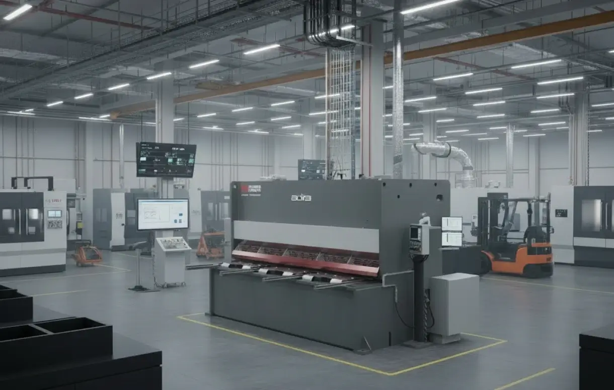

Adira guillotine metal shear on production floor with CNC workstation and forklift
Heavy-Duty Hydraulic Guillotine Shears for Thick Plate and Oversized Work
When the job calls for cutting structural steel, heavy-duty stainless, or oversized sheet stock, a heavy-duty hydraulic guillotine shear is the tool that gets it done. MC Machinery’s rake angle shears use a powerful vertical cutting motion to handle plates 25 mm thick and beyond, giving fabrication shops the muscle needed for their most demanding work.
The adjustable cutting angle is what makes our shears especially versatile. Operators can fine-tune the right rake for the material at hand, easily alternating between thin-gauge sheet and heavy plate throughout the day. Independent hold-down control, CNC-driven blade movement, and deep throat geometry round out the package, producing clean, consistent cuts across a wide range of thicknesses and material types.

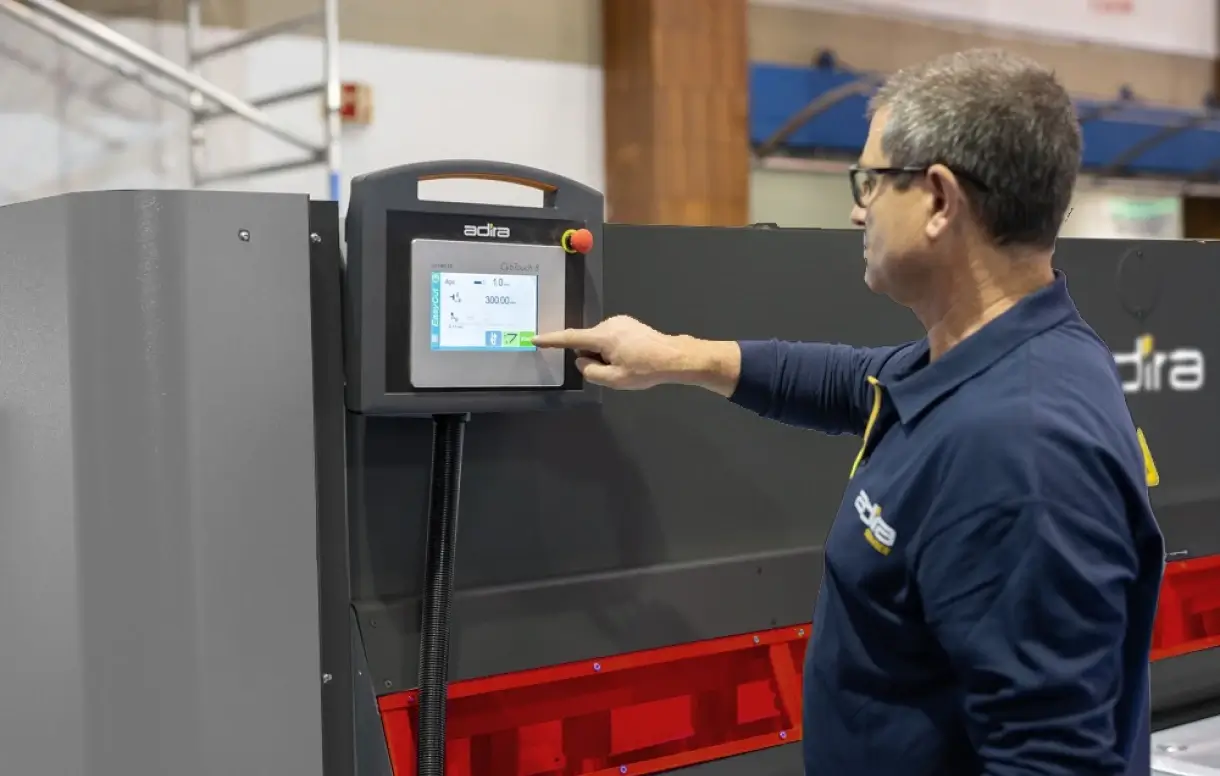

Operator programming hydraulic guillotine shear using Adira CybTouch CNC pendant
GV Series Hydraulic Shears
The GV Series is MC Machinery’s heavy-duty hydraulic guillotine shear line, available in four base configurations with extensive customization options. Every GV Series machine features a variable-rake-angle hydraulic shear in welded steel construction, a Cybelec CybTouch8 color touchscreen controller on a pendant arm, automatic hydraulic swing-up of the back gauge during cut, and a set of four-edged blades rated for stainless cutting.
