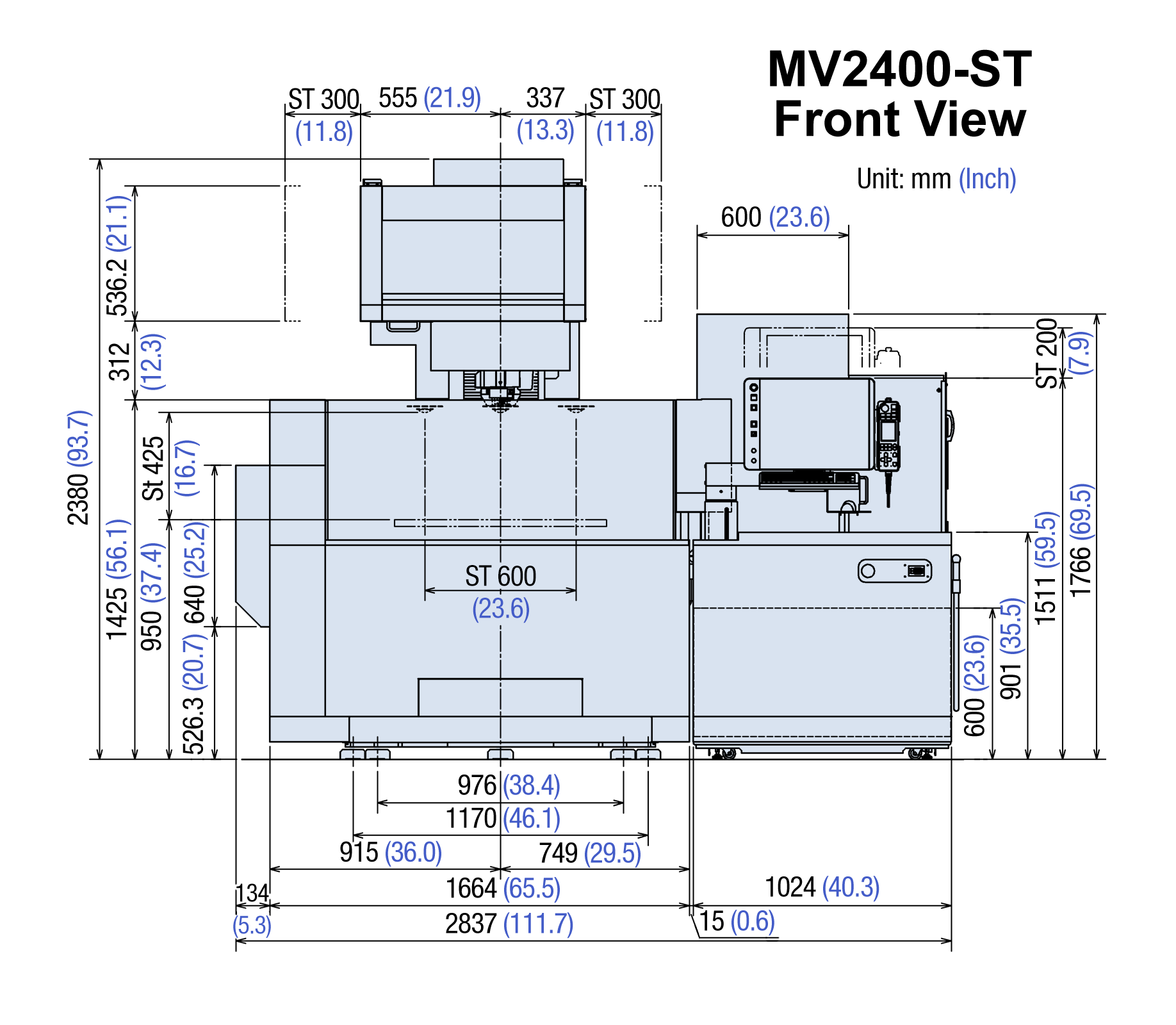

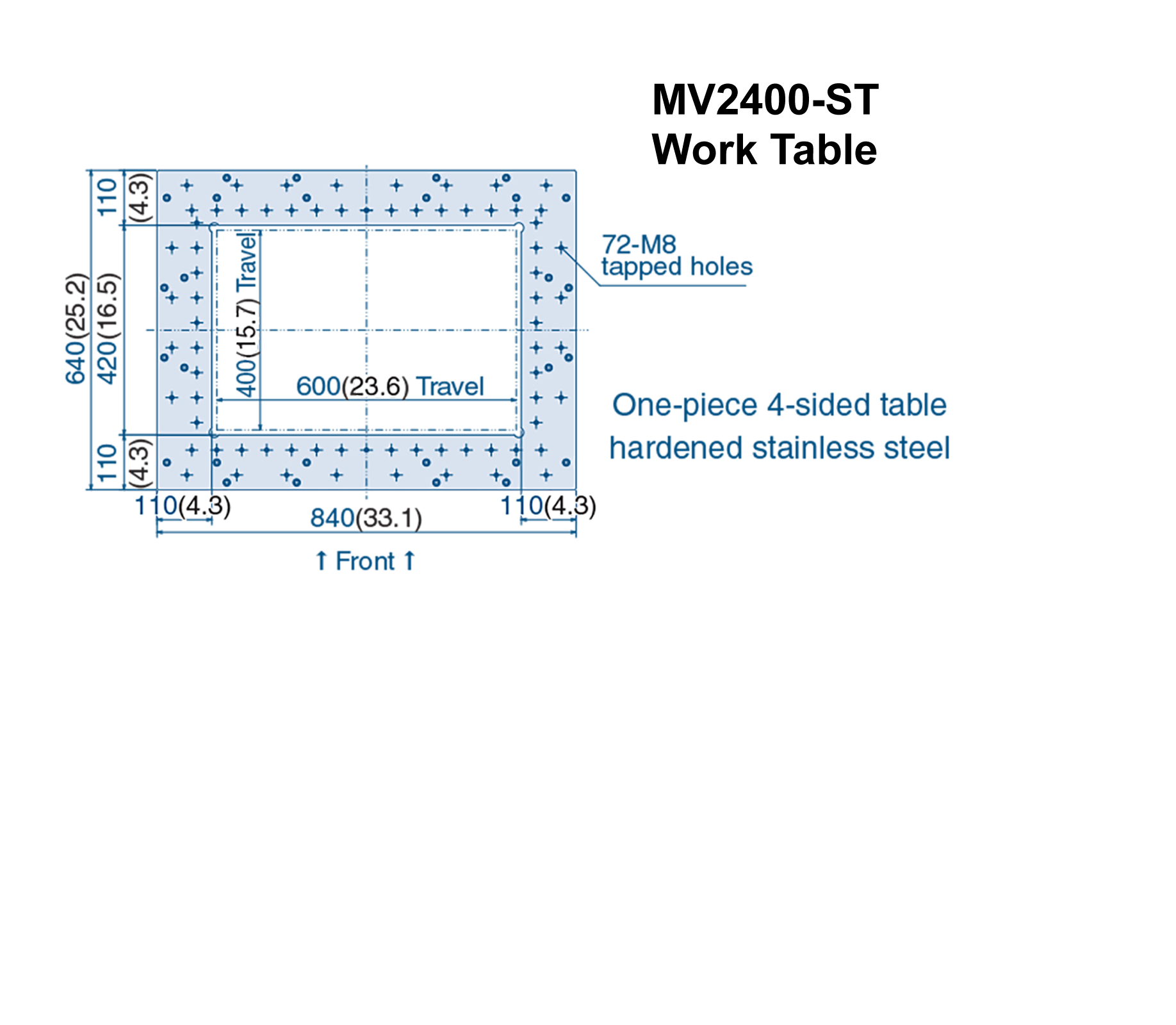

Machine Travels: X x Y x Z in (mm) 23.6 x 15.7 x 16.5 (600 x 400 x 425)
Maximum Workpiece Dimensions: W x D x H in (mm) 41.3 x 32.3 x 16.3 (1050 x 820 x 420)
Max. Submerged Workpiece Weight: lb (kg) 3300 (1500)
Table Dimensions: in (mm) 33.0 x 25.2 (840 x 640)
U/V Travels (from center): in (mm) ±3.0 x ±3.0 (±75 x ±75)
Taper Angle @ Thickness: in (mm) 15 deg.@ 10.2 (15 deg.@ 260)
Wide Angle Taper (Optional Guides Required) 45 deg. @ 2.4″ (No AT Possible)
Table Rapid Feed Speed: in/min (mm/min) 51.2 (1300)
Power Supply V350-V
Minimum Drive Unit / Resolution 0.00001 / 2 millionths (0.0001 / 0.05µm)
User Program Storage [Hard Disk Size] 1 GB [80 GB]
Wire Diameter Possible: in (mm) 0.004~0.012 (0.1~0.3)
Minimum Start Hole Diameter: in (mm) 0.02 (0.5)
Max. Wire Spool size On Machine / Cabinet STD: lb (kg) 22 / 44 (10 / 20)
Filters / Type 2 / Paper
Filter Tank Capacity: gal (L) 260 (985)

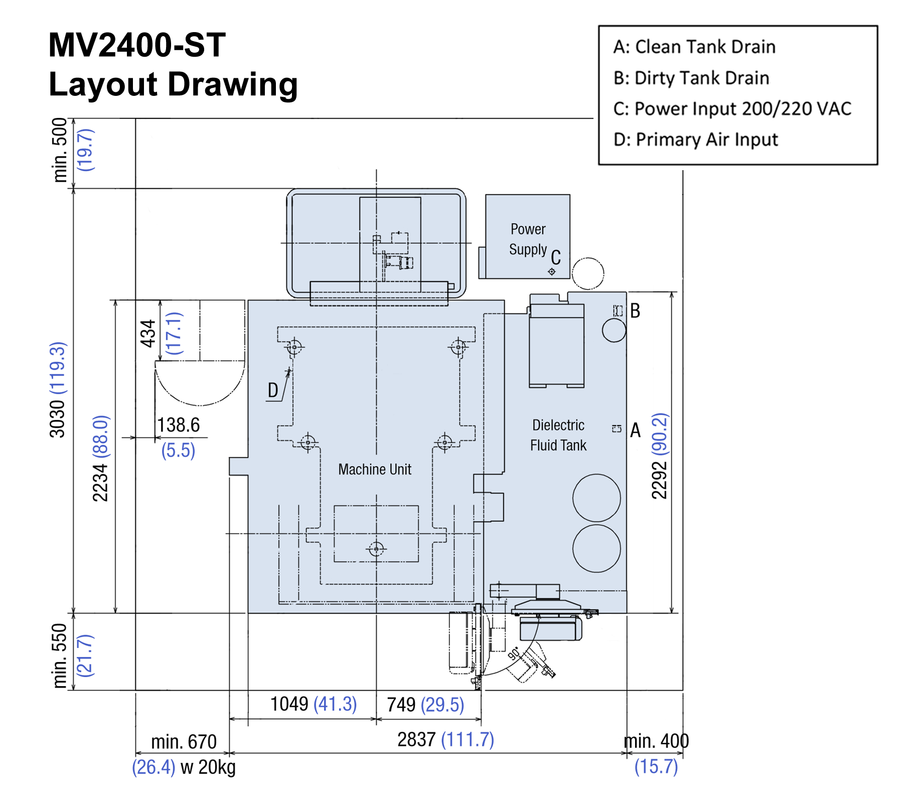

Machine System Dimensions: in (mm) 111.7 x 137.4 (2837 x 3490)
Machine Installed Height: in (mm) 93.7 (2380)
Machine System Weight: lb (kg) 9500 (4300)
Fluid System Weight: lb (kg) 880 (400)
Power Requirements [KVA] 200-230V [13.5] Built in AVR
Compressed Air Requirements 2.7 cu.ft./min. @ 71~100 psi
