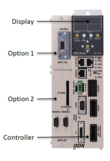

The DSP3000 controller platform is designed for customization. This version comes equipped with standard STO functionality on-board (Non-STO version is also available). Fit along side other control components in a cabinet, this controller provides all the functionality and flexibility you need for a variety of pressing operations

Option Display
| Model | Description |
| MFC-DP01 | Display unit |
Option 1 Slot (Fieldbus)
| MFC-DT-S | Discrete I/O (32+32) |
| MFC-CC-S | CC-Link V2 |
| MFC-DN-S | DeviceNet |
| MFC-PB-S | Profibus DP-V1 |
| MFC-EN-S | EtherNet I/P |
| MFC-PN-S | ProfiNet IO |
| MFC-CI-S | CC-Link IE Field |
| MFC-EC-S | EtherCAT |
Option 2 Slot (CompactFlash & Reporting)
| MFC-CF-S | CompactFlash module + RS232 (x2) |
