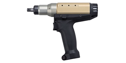

Standard – Pistol HAND HELD
Pistol Hand Held Nutrunners available in sizes from 3.8 — 200 Nm.  Optional hanging bracket and torque multipliers are available. We recommend torque reaction devices for use over 15Nm.
Model Pin Lock Sq. Drive Controller Torque Range
(Nm / ft*lb)
Speed
(rpm)
Width
(mm)
Body Length
(mm / in)
Weight
(kg / lb)
Square Drive 2-D Print
(pdf)
2-D Drawing
(dxf)
3-D Model
(stp)
HFT-015M50-P1 HFT-015M50-P1-P MFC-B024A 3.8 – 15 / 2.8 – 11.1 1190 44 218 / 8.58
1.1 / 2.43
3/8″ HFT-015M50-P1.pdf HFT-015M50-P1.dxf HFT-015M50-P1.stp
HFT-030M120-P1 HFT-030M120-P1-P MFC-B024A 7.5 – 30 / 5.5 – 22.1 1540 55 260 / 10.24
1.8 / 3.97
3/8″ HFT-030M120-P1.pdf HFT-030M120-P1.dxf HFT-030M120-P1.stp
HFT-035M80-P1 HFT-035M80-P1-P MFC-B024A 8.8 – 35 / 6.5 – 25.8 778 44 242 / 9.53
1.37 / 3.02
3/8″ HFT-035M80-P1.pdf HFT-035M80-P1.dxf HFT-035M80-P1.stp
HFT-050M120-P1 HFT-050M120-P1-P MFC-B024A
12.5 – 50 / 9.2 – 36.9
869 55 260 / 10.24
1.8 / 3.97
1/2″ HFT-050M120-P1.pdf HFT-050M120-P1.dxf HFT-050M120-P1.stp
HFT-080M120-P1 HFT-080M120-P1-P MFC-B024A
20 – 80 / 14.8 – 59
570 55
266 / 10.47
1.9 / 4.19
1/2″ HFT-080M120-P1.pdf HFT-080M120-P1.dxf HFT-080M120-P1.stp
HFT-200M120-P1 HFT-200M120-P1-P MFC-B024A
50 – 200 / 36.9 – 147.5
216 63
317 / 12.48
3.2 / 7.05
3/4″ HFT-200M120-P1.pdf HFT-200M120-P1.dxf HFT-200M120-P1.stp
HFT-035M80-P1-X13001 HFT-035M80-P1-X13001 -P MFC-B024A
778 44
242 / 9.53
1.37 / 3.02
3/8″ HFT-035M80-P1-X13001.pdf HFT-035M80-P1-X13001.dxf HFT-035M80-P1-X13001.stp
HFT-060M80-P1-X HFT-060M80-P1-X-P MFC-B024A
15 – 60 / 11.1 – 44.3
461 60
275 / 10.83
2.5 / 5.51
1/2″ HFT-060M80-P1-X.pdf HFT-060M80-P1-X.dxf HFT-060M80-P1-X.stp
Safe-StarT – Pistol HAND HELD
Safe-Start [Anti-Cross Thread pulse mechanism and gyroscope model] Pistol Hand Held Nutrunners available in sizes from 3.8 — 200 Nm.  Optional hanging bracket and torque multipliers are available. We recommend torque reaction devices for use over 15Nm.
