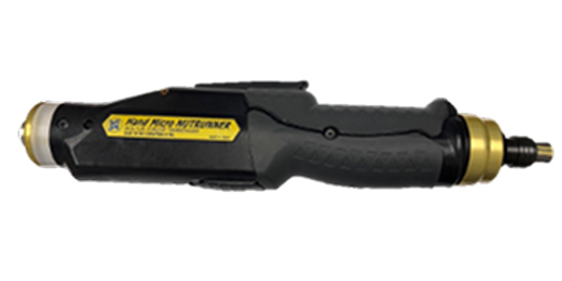

MICRO HAND HELD
Micro Hand Held Nutrunners available in sizes from 0.2 — 2.4Nm. Optimal for electronics and small screws where precision is required.
| Model | Pin Lock Sq. Drive | Controller | Torque Range (Nm / in*lb) |
Speed (rpm) |
Width (mm) |
Body Length (mm / in) |
Weight (kg / lb) |
Square Drive | 2-D Print (pdf) |
2-D Drawing (dxf) |
3-D Model (stp) |
| MFT-080M10-PR2 | MFT-080M10-PR2 | MFC-S008 |
0.2 – 0.8 / 1.77 – 7.08
2220 | 60.31 |
261.3 / 10.29
0.56 / 1.23
1/4″ Hex | MFT-080M10-PR2.pdf | MFT-080M10-PR2.dxf | MFT-080M10-PR2.stp |
| MFT-160M10PR2 | MFT-160M10PR2 | MFC-S008 |
0.4 – 1.6 / 3.54 – 14.16
1250 | 60.31 |
261.3 / 10.29
0.56 / 1.23
1/4″ Hex | MFT-160M10PR2.pdf | MFT-160M10PR2.dxf | MFT-160M10PR2.stp |
| MFT-240M10-PR2 | MFT-240M10-PR2 | MFC-S008 |
0.6 – 2.4 / 5.31 – 21.24
800 | 60.31 |
261.3 / 10.29
0.56 / 1.23
1/4″ Hex | MFT-240M10-PR2.pdf | MFT-240M10-PR2.dxf | MFT-240M10-PR2.stp |

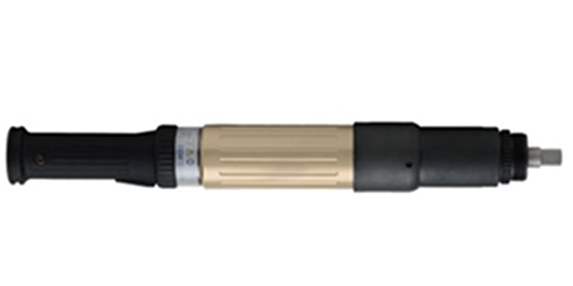

STANDARD – STRAIGHT HAND HELD
Straight tools are available in sizes from 10 — 130Nm. A throttle lever & reverse switch are provided standard. Optional sliding spindles, offset gearing and tube nut heads are available. Tools may be hung or mounted by using a clamp collar (optimal location is on one of the locking nuts behind the output drive).
| Model | Pin Lock Sq. Drive | Controller | Torque Range (Nm / ft*lb) |
Speed (rpm) |
Width (mm) |
Weight (kg / lb) |
2-D Drawing (dxf) |
3-D Model (stp) |
| HFT-010M50-S1-20 | HFT-010M50-S1-20-P | MFC-B024A |
2.5 – 10 / 1.8 – 7.4
1800 | 48 |
331 / 13.03
1.3 / 2.87
3/8″ | HFT-010M50-S1-20.pdf | HFT-010M50-S1-20.dxf | HFT-010M50-S1-20.stp |
| HFT-015M80-S1-20 | HFT-015M80-S1-20-P | MFC-B024A |
3.8 – 15 / 2.8 – 11.1
1600 | 48 |
351 / 13.82
1.4 / 3.09
3/8″ | HFT-015M80-S1-20.pdf | HFT-015M80-S1-20.dxf | HFT-015M80-S1-20.stp |
| HFT-025M80-S1-20 | HFT-025M80-S1-20-P | MFC-B024A |
6.3 – 25 / 4.6 – 18.4
1000 | 48 |
351 / 13.82
1.43 / 3.15
3/8″ | HFT-025M80-S1-20.pdf | HFT-025M80-S1-20.dxf | HFT-025M80-S1-20.stp |
| HFT-040M80-S1-20 | HFT-040M80-S1-20-P | MFC-B024A |
10 – 40 / 7.4 – 29.5
694 | 48 |
351 / 13.82
1.43 / 3.15
3/8″ | HFT-040M80-S1-20.pdf | HFT-040M80-S1-20.dxf | HFT-040M80-S1-20.stp |
| HFT-055M120-S1-20 | HFT-055M120-S1-20-P | MFC-B024A |
13.7 – 55 / 10.1 – 40.6
861 | 54 |
404.5 / 15.93
2.4 / 5.29
1/2″ | HFT-055M120-S1-20.pdf | HFT-055M120-S1-20.dxf | HFT-055M120-S1-20.stp |
| HFT-090M120-S1-20 | HFT-090M120-S1-20-P | MFC-B024A |
22.5 – 90 / 16.6 – 66.4
488 | 54 |
417.5 / 16.44
2.7 / 5.95
1/2″ | HFT-090M120-S1-20.pdf | HFT-090M120-S1-20.dxf | HFT-090M120-S1-20.stp |
| HFT-130M120-S1-20 | HFT-130M120-S1-20-P | MFC-B024A |
32.5 – 130 / 24 – 95.9
318 | 54 |
417.5 / 16.44
2.7 / 5.95
1/2″ | HFT-130M120-S1-20.pdf | HFT-130M120-S1-20.dxf | HFT-130M120-S1-20.stp |

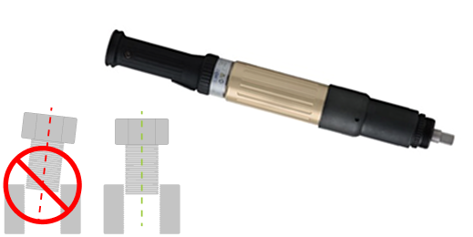

SAFE-START – STRAIGHT HAND HELD
Safe-Start [Anti-Cross Thread pulse mechanism and gyroscope model] Straight Hand Held Nutrunners available in sizes from 2.5 — 200 Nm. Optional hanging bracket and torque multipliers are available. We recommend torque reaction devices for use over 10Nm.
Speed (rpm) |
Width (mm) |
Weight (kg / lb) |
Square Drive | Mounting Information | 2-D Print (pdf) |
2-D Drawing (dxf) |
3-D Model (stp) |
| HFT-010M50-S1-20-GA | HFT-010M50-S1-20-GA-P | MFC-B024A |
1800 | 48 | 331 / 13.03 |
1.3 / 2.87
3/8″ | HFA-RP01 | HFT-010M50-S1-20-GA.pdf | HFT-010M50-S1-20-GA.dxf | HFT-010M50-S1-20-GA.stp |
| HFT-015M80-S1-20-GA | HFT-015M80-S1-20-GA-P | MFC-B024A |
1600 | 48 |
351 / 13.82
1.4 / 3.09
3/8″ | HFA-RP01 | HFT-015M80-S1-20-GA.pdf | HFT-015M80-S1-20-GA.dxf | HFT-015M80-S1-20-GA.stp |
| HFT-025M80-S1-20-GA | HFT-025M80-S1-20-GA-P | MFC-B024A |
1000 | 48 |
351 / 13.82
1.43 / 3.15
3/8″ | HFA-RP01 | HFT-025M80-S1-20-GA.pdf | HFT-025M80-S1-20-GA.dxf | HFT-025M80-S1-20-GA.stp |
| HFT-040M80-S1-20-GA | HFT-040M80-S1-20-GA-P | MFC-B024A |
694 | 48 |
351 / 13.82
1.43 / 3.15
3/8″ | HFA-RP01 | HFT-040M80-S1-20-GA.pdf | HFT-040M80-S1-20-GA.dxf | HFT-040M80-S1-20-GA.stp |
| HFT-055M120-S1-20-GA | HFT-055M120-S1-20-GA-P | MFC-B024A |
861 | 54 |
404.5 / 15.93
2.4 / 5.29
1/2″ | 47mm Hex nut | HFT-055M120-S1-20-GA.pdf | HFT-055M120-S1-20-GA.dxf | HFT-055M120-S1-20-GA.stp |
| HFT-090M120-S1-20-GA | HFT-090M120-S1-20-GA-P | MFC-B024A |
488 | 54 |
417.5 / 16.44
2.7 / 5.95
1/2″ | 47mm Hex nut | HFT-090M120-S1-20-GA.pdf | HFT-090M120-S1-20-GA.dxf | HFT-090M120-S1-20-GA.stp |
| HFT-130M120-S1-20-GA | HFT-130M120-S1-20-GA-P | MFC-B024A |
318 | 54 |
417.5 / 16.44
2.7 / 5.95
1/2″ | 47mm Hex nut | HFT-130M120-S1-20-GA.pdf | HFT-130M120-S1-20-GA.dxf | HFT-130M120-S1-20-GA.stp |

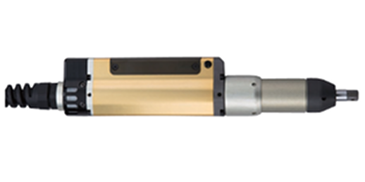

PUSH-TO-START – STRAIGHT HAND HELD
Push-To-Start Hand Held Nutrunner from 7.5 – 28Nm. Ideal for simplifying assembly without compromising quality. We recommend torque reaction devices for use over 10Nm.
Speed (rpm) |
Width (mm) |
Weight (kg / lb) |
2-D Drawing (dxf) |
3-D Model (stp) |
| HFT-030M80-DP-H | HFT-030M80-DP-H-P | MFC-B024A | 7.5 – 28 / 5.5 – 20.7 | 980 | 288 / 11.34 | 1.3 / 2.87 | 3/8″ | HFT-030M80-DP-H.pdf | HFT-030M80-DP-H.dxf | HFT-030M80-DP-H.stp |
