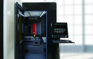

The Mitsubishi GX-F ADVANCED AI-enabled fiber laser can track more than 300 cut conditions for nearly any kind of material and gauge.

● Lasers with intuitive controls, artificial intelligence and augmented reality. Mitsubishi’s GX-F ADVANCED fiber laser features a cutting head with a camera and microphone, serving as the eyes and ears that watch and listen to the cutting process. The GX-F ADVANCED AI-enabled fiber laser can track more than 300 cut conditions for nearly any kind of material and gauge.
