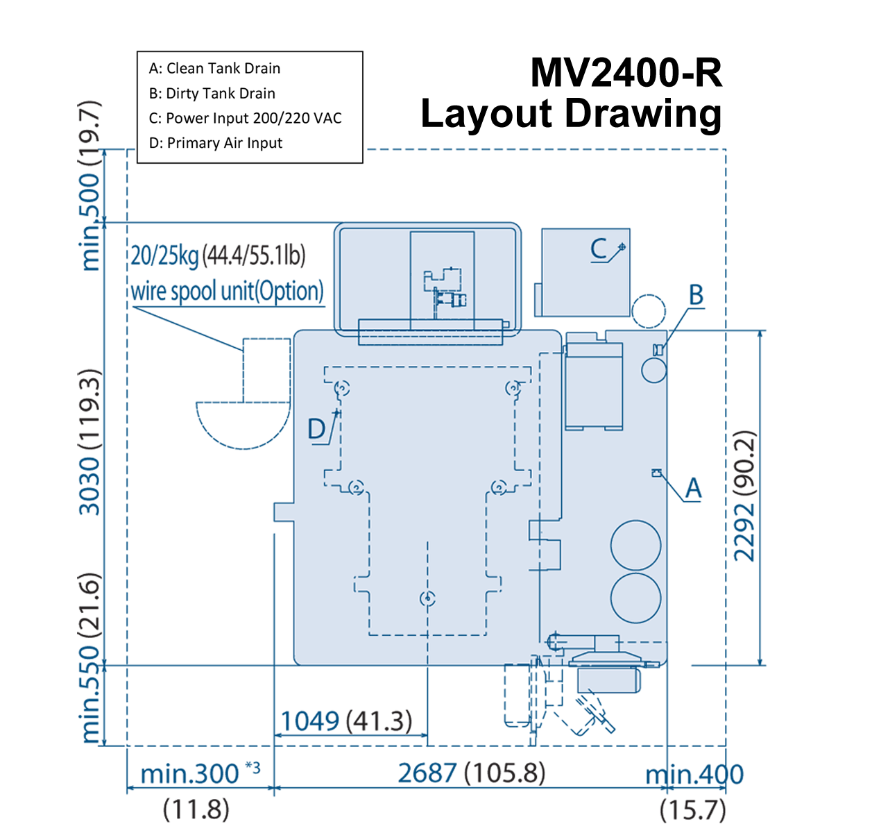

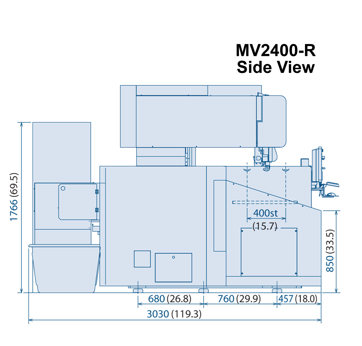

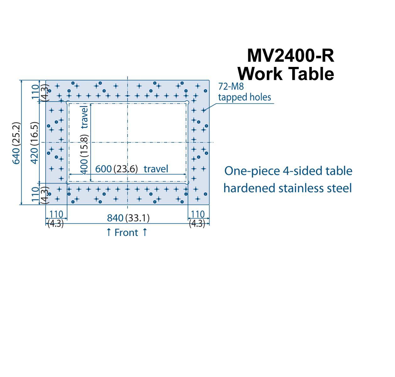

| Machine Travels: X x Y x Z in (mm) | 23.6 x 15.7 x 12.2 (600 x 400 x 310) |
| Maximum Workpiece Dimensions: W x D x H in (mm) | 41.3 x 32.3 x 12.0 (1050 x 820 x 305) |
| Max. Submerged Workpiece Weight: lb (kg) | 3307 (1500) |
| Table Dimensions: in (mm) | 33.0 x 25.2 (840 x 640) |
| U/V Travels (from center): in (mm) | ±3.0 x ±3.0 (±75 x ±75) |
| Taper Angle @ Thickness: in (mm) | 15 deg.@ 10.2 (15 deg.@ 260) |
| Wide Angle Taper (Optional Guides Required) | 45 deg. @ 2.4″ 60mm (No AT Possible) |
| Table Rapid Feed Speed: in/min (mm/min) | 51.2 (1300) |
| Power Supply | V350-V |
| Minimum Drive Unit / Resolution | 0.000002 / 2 µin ( 0.00005 / 50nm) |
| User Program Storage [Hard Disk Size] | 1 GB [32 GB CFAST Card Size] |
| Wire Diameter Possible: in (mm) | 0.004~0.012 (0.1~0.3) |
| Minimum Start Hole Diameter: in (mm) | 0.02 (0.5) |
| Max. Wire Spool size On Machine / Cabinet STD: lb (kg) | 22 / 44 (10 / 20) |
| Filters / Type | 2 / Paper |
| Filter Tank Capacity: gal (L) | 227 (860) |
| Machine System Dimensions: in (mm) | 105.8 x 119.3 (2687 x 3030) |
| Machine Installed Height: in (mm) | 84.6 (2150) |
| Machine System Weight: lb (kg) | 7716 (3500) |
| Fluid System Weight: lb (kg) | 711 (350) |
| Power Requirements [KVA] | 200-230V [13.5] Built in AVR |
| Compressed Air Requirements | 2.7 cu.ft./min. @ 71~100 psi |
