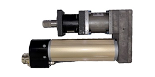

U-STYLE
The CFT U-Style uses a gearbox to reduce the installation height for areas with space constraints. This is the most compact nutrunner offered in the line.
