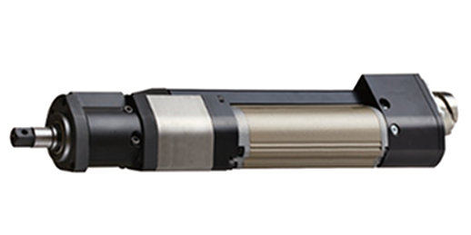

HIGH SPEED SEATING – STRAIGHT NUTRUNNER
The CFT straight high-speed seating nutrunner is ideal for beating cycle times. The tool has an internal dampener that minimizes overshoot in high speed, hard joint applications.
| Model | Controller | Torque Range (Nm / ft*lb) |
Speed (rpm) |
Min. C-C (mm) |
Installation Length* (mm / in) |
Weight (kg / lb) |
Square Drive | 2-D Print (pdf) |
2-D Drawing (dxf) |
3-D Model (stp) |
| CFT-101RS1-S-H | MFC-S024 | 2 – 10 / 1.5 – 7.4 | 3000 | 39 | 290.4 / 11.43 |
1.39 / 3.1
3/8″ | CFT-101RS1-S-H.pdf | CFT-101RS1-S-H.dxf | CFT-101RS1-S-H.stp | |
| CFT-201RS1-S-H | MFC-S024 | 4 – 20 / 3 – 14.8 | 1293 | 39 |
305.4 / 12.02
1.5 / 3.3
3/8″ | CFT-201RS1-S-H.pdf | CFT-201RS1-S-H.dxf | CFT-201RS1-S-H.stp | |
| CFT-281RS1-S-H | MFC-S024 |
5.6 – 28 / 4.1 – 20.7
992 | 39 |
308.4 / 12.14
1.55 / 3.4
3/8″ | CFT-281RS1-S-H.pdf | CFT-281RS1-S-H.dxf | CFT-281RS1-S-H.stp | |
| CFT-401RS1-S-H | MFC-S024 | 8 – 40 / 5.9 – 29.5 | 712 | 39 |
308.4 / 12.14
1.55 / 3.4
3/8″ | CFT-401RS1-S-H.pdf | CFT-401RS1-S-H.dxf | CFT-401RS1-S-H.stp | |
| CFT-801RS3-S-H | MFC-S060 |
16 – 80 / 11.8 – 59
1015 | 50 |
383.4 / 15.09
3.4 / 7.5
1/2″ | CFT-801RS3-S-H.pdf | CFT-801RS3-S-H.dxf | CFT-801RS3-S-H.stp | |
| CFT-132RS3-S1-H | MFC-S060 |
26 – 130 / 19.2 – 95.9
574 | 50 |
383.4 / 15.09
3.4 / 7.5
1/2″ | CFT-132RS3-S1-H.pdf | CFT-132RS3-S1-H.dxf | CFT-132RS3-S1-H.stp | |
| *Installation length does not include the cable | |||||||||||
| Cable exits the top of the nutrunner | |||||||||||
| Nutrunners designed for critical applications with hard joints and short cycle times | |||||||||||

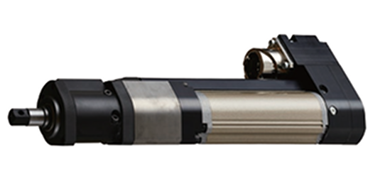

L-Style Connector – STRAIGHT NUTRUNNER
The CFT straigh L-style connector nutrunner uses a cable connection that is 180 degree connection making it even more compact, with the same performance as the regular version.
Speed (rpm) |
Min. C-C (mm) |
Weight (kg / lb) |
2-D Drawing (dxf) |
3-D Model (stp) |
| CFT-051RS1-SL | MFC-S024 |
1 – 5 / 0.7 – 3.7
1330 | 41 |
231 / 9.09
1.2 / 2.6
3/8″ | CFT-051RS1-SL.pdf | CFT-051RS1-SL.dxf | CFT-101RS1-SL.stp | |
| CFT-101RS1-SL | MFC-S024 |
2 – 10 / 1.5 – 7.4
3000 | 39 |
236 / 9.29
1.26 / 2.8
3/8″ | CFT-101RS1-SL.pdf | CFT-101RS1-SL.dxf | CFT-101RS1-SL.stp | |
| CFT-201RS1-SL | MFC-S024 |
4 – 20 / 3 – 14.8
1293 | 39 |
251 / 9.88
1.42 / 3.1
3/8″ | CFT-201RS1-SL.pdf | CFT-201RS1-SL.dxf | CFT-201RS1-SL.stp | |
| CFT-281RS1-SL | MFC-S024 |
992 | 39 |
254 / 10
1.42 / 3.1
3/8″ | CFT-281RS1-SL.pdf | CFT-281RS1-SL.dxf | CFT-281RS1-SL.stp | |
| CFT-401RS1-SL | MFC-S024 |
8 – 40 / 5.9 – 29.5
712 | 39 |
254 / 10
1.42 / 3.1
3/8″ | CFT-401RS1-SL.pdf | CFT-401RS1-SL.dxf | CFT-401RS1-SL.stp | |
| CFT-801RS3-SL | MFC-S060 |
16 – 80 / 11.8 – 59
1015 | 50 |
329 / 12.95
3.5 / 7.7
1/2″ | CFT-801RS3-SL.pdf | CFT-801RS3-SL.dxf | CFT-801RS3-SL.stp | |
| CFT-132RS3-S1L | MFC-S060 |
574 | 50 |
329 / 12.95
3.4 / 7.5
1/2″ | CFT-132RS3-S1L.pdf | CFT-132RS3-S1L.dxf | CFT-132RS3-S1L.stp | |
| CFT-202RS3-SL | MFC-S060 |
40 – 200 / 29.5 – 147.5
387 | 59 |
341 / 13.43
4.3 / 9.5
5/8″ | CFT-202RS3-SL.pdf | CFT-202RS3-SL.dxf | CFT-202RS3-SL.stp | |
| CFT-302RS3-SL | MFC-S060 |
60 – 300 / 44.3 – 221.3
260 | 71 |
388 / 15.28
5.8 / 12.8
3/4″ | CFT-302RS3-SL.pdf | CFT-302RS3-SL.dxf | CFT-302RS3-SL.stp | |
| Cable exit adjustable in 90 degree increments | |||||||||||
