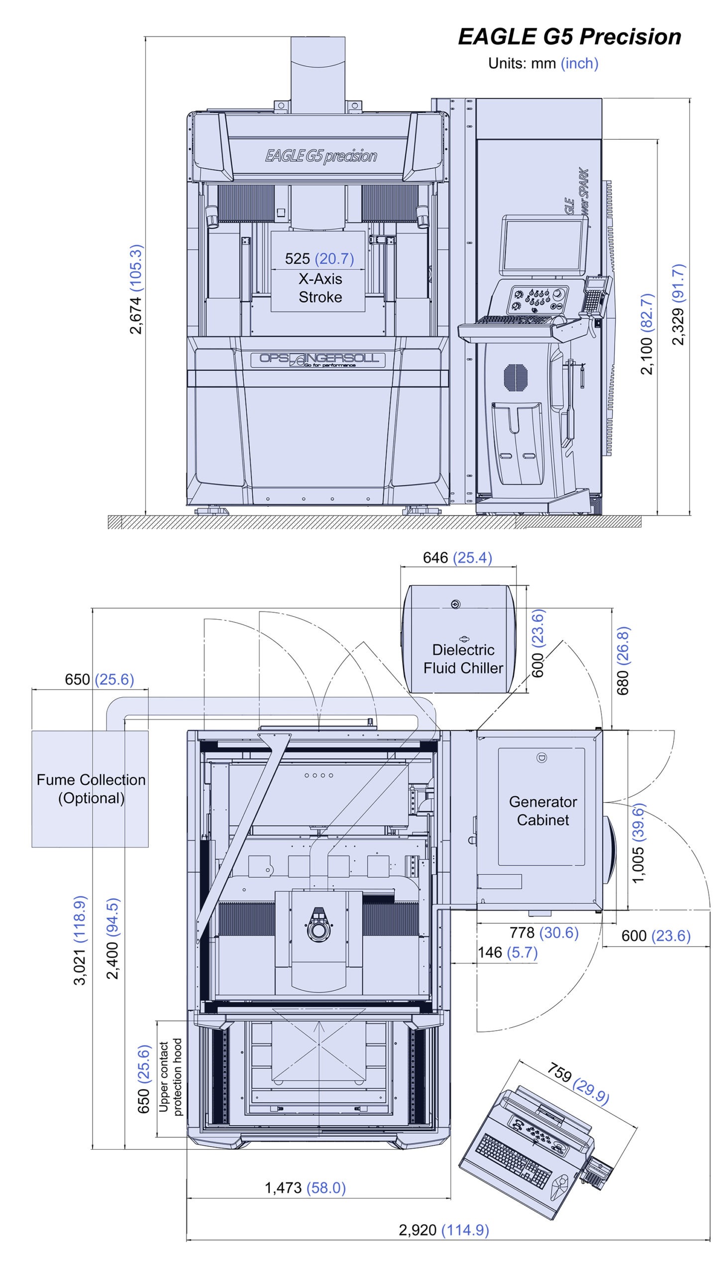

| MACHINE | ||
| Machine weight | lb. (kg) | 11,795 (5,350) |
| Generator weight | lb. (kg) | 1,411 (640) |
| Power input | kVA | 16 |
| Fuse protection | A | 32 |
| Voltage / Frequency | V/Hz | 400/60 |
| WORK TANK | ||
| Type | Rise and fall tank – filled movable | |
| Clear dimensions (L x W x H) | inch (mm) | 30.3 x 26.4 x 17.3 (770 x 670 x 440) |
| Dielectric fluid level max. programmable/automatic | inch (mm) | 14.7 (375) |
| WORK HEAD | ||
| Max. head load | lb. (kg) | 220 (100) |
| Distance electrode-clamping chuck to work table min./max. | inch (mm) | 5.3/23.0 (135/585)* |
| INTEGRATED C-AXIS | ||
| Rotation Speed (adjustable) | RPM | 1-20 |
| Angle positioning | degree | 0.001 |
| Load capacity for manual electrode change | lb. (kg) | 110 (50)* |
| Load capacity for automatic electrode change | lb. (kg) | 33 (15)* |
| Movement of inertia, max. | lb./ft2 (kg/m2) | 9.5 (0.4)* |
| WORK TABLE | ||
| Surface (L x W) | inch (mm) | 29.5 x 25.6 (750 x 650) |
| Load capacity | lb. (kg) | 2200 (1,000) |
| TRAVEL WAYS | ||
| X / Y / Z inside the work tank | inch (mm) | 20.7 x 15.7 x 17.7 (525 x 400 x 450) |
| Y (by electrode changing position) | inch (mm) | 26.6 (675) |
| CONTROL EAGLE PowerSPARK One | ||
| HMI | OS | Windows® 7 ultimate |
| Type of drive | digital AC-servo | Direct-drive Ball screw |
| X, Y, Z rapid traverse | inch/min. (mm/min.) | 197 (5,000) |
| Power Jump Z max. | inch/min. (mm/min.) | 708 (18,000) |
| Power Jump Plus X,Y (option) | inch/min. (mm/min.) | 197 (5,000) |
| DIELECTRIC SUPPLY | ||
| Filter system | Cartridge (integrated) | |
| Filter surface area | sq.ft. (m2) | 172 (16) |
| Dielectric fluid, total volume | gal. (ltr.) | 106 (400) |
| ELECTRODE CHANGER | ||
| Type (option) | Direct pick-up rotary disc | |
| Positions (option) | 20 (30) | |
| Electrode weight | ||
| – Single electrode | lb. (kg) | 33 (15)* |
| – Total weight | lb. (kg) | 132 (60)* |
| GENERATOR | ||
| Type (Option) | PT60 (PT110) | Adaptive current |
| Machining power, max. (option) | A | 60 (110) |
| ADDITIONAL FEATURES | ||
| Automatic lubrication | Standard | |
| Chiller, cooling power | kW | 3.9 |
| CO2-fire extinguisher, DIN 14497, size | lb. (kg) | 13 (6) |
