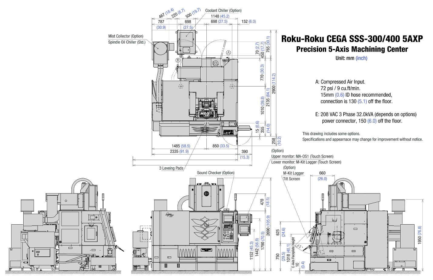

| Machine Travels: X x Y x Z in (mm) | 20.1 x 16.1 x 12.2 (510 x 410 x 310) |
| Spindle Speed | 200 ~ 30,000 RPM |
| Spindle HP | 20.0 |
| Spindle Lubrication | Oil Mist |
| Tool Changer Size | 20 Position Standard |
| Positioning Accuracy/Repeatability: in (μm) | ±0.000039” / ±0.000020” (±1.0 / ±0.5) |
| Rotary Table Faceplate: in (mm) | Ø 5.9 (Ø150) |
| Max. Tilting A-Axis Angle: deg. | -110 ~ +30 |
| Rotary C-Axis Index Accuracy | ±4.0 arc sec. |
| Tilting A-Axis Index Accuracy | ± 4.0 arc sec. |
| Faceplate to Spindle Nose Distance: in (mm) | 1.85 ~ 14.05 (47 ~ 357) |
| Max. Workpiece Weight: lb (kg) | 20 (44) |
| Coolant Tank Capacity: gal (L) | 80 (300) |
| Faceplate Height from Floor: in (mm) | 39.5 (1003) |
| Actual Measured Circularity (4.0″ dia. @8 IPM): in (μm) | 0.000044 (0.11) |
| Spindle Taper | HSK-E40 |
| Spindle Air Purge | Standard |
| Air Blast through Spindle | NA |
| Oil Mist with Collector | Optional |
| Linear Scales X, Y, Z – axes | Heidenhain 0.000002mm Standard |
| Rapid Traverse Speed: in/min. (m/min.) | 590 (15.0) |
| Cutting Speed (Normal Mode): in/min. (mm/min.) | 0.04 – 394 (1 ~ 10,000) |
| Cutting Speed (GR Super PC Mode): in/min. (m/min.) | 590 (1.5) |
| Dust Collection System | NA |
| Machine Weight: lb (kg) | 12,125 (5,500) |
| Machine Height: in (mm) | 106.0 (2690) |
| Required Floor Space: in (mm) | 91.5 x 100.4 (2,325 x 2,550) w coolant chiller option |
| Control Unit | Fanuc 31i-B5 Super High-Speed Processor, Al Contour Control II and 5-Axis machining package |
| Power Requirements KVA | 200 ~ 220VAC: 32.0KVA |
| Air Supply | 17.5 cu.ft./min @ 72 psi |
