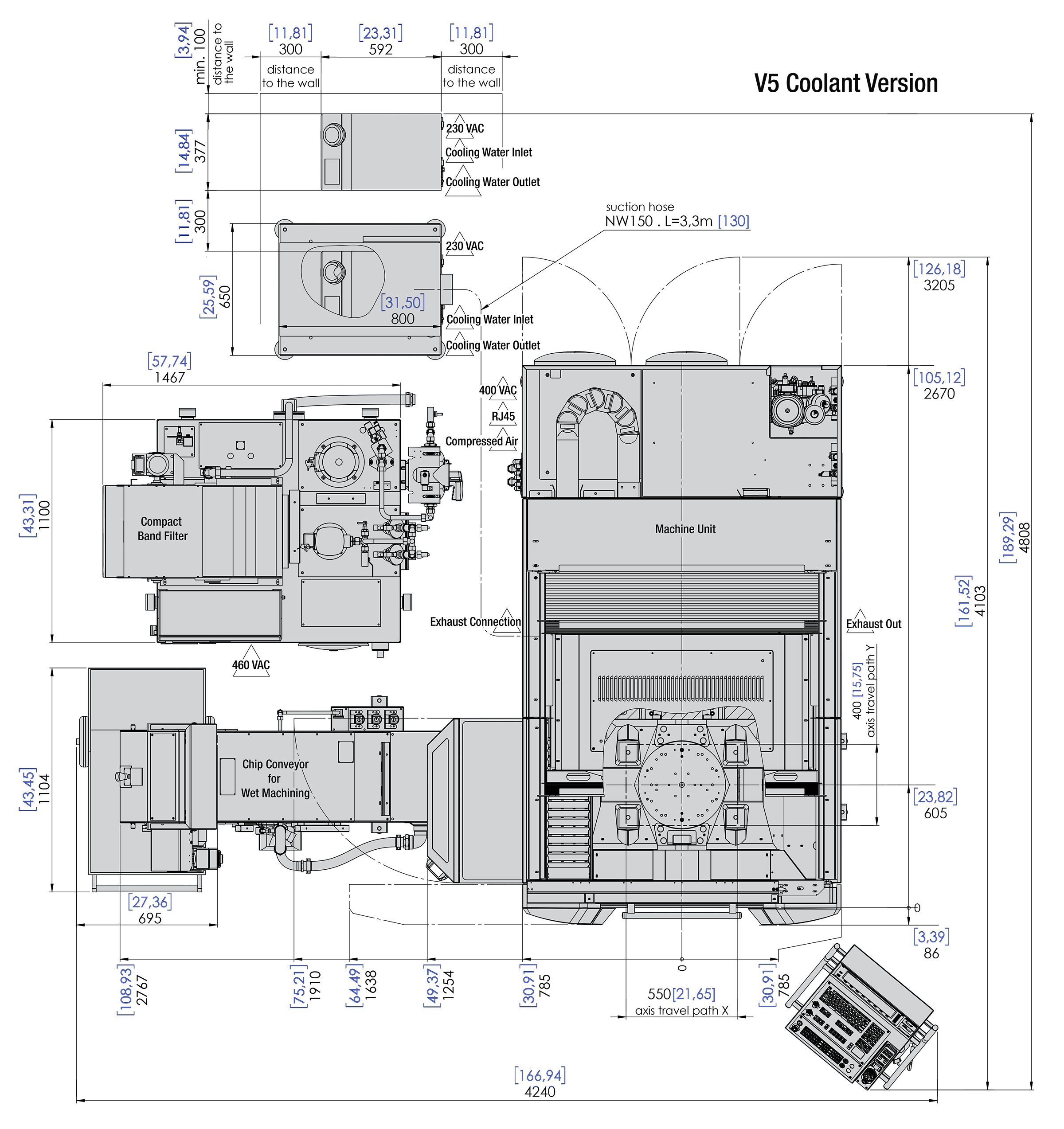

| Machine Travels: X x Y x Z in (mm) | 21.6 x 15.7 x 15.7 (550 x 400 x 400) |
| B-Axis Tilt Range Degree (RPM) | -140° ~ 60° (25) |
| C-Axis Rotation Range Degree (RPM) | 360° (100) |
| Rotary Table Faceplate: dia. (mm) | 15.75 (400) |
| Max Workpiece Height: Faceplate/Pallet (mm) | 15.7/12.7 (400/325) |
| Max Rotary Table Cap: lb. (kg) | 440 (200) |
| Spindle Speed | 36,000 RPM |
| Spindle HP (S1 100%) | 33 HP (24.8 kw) |
| Spindle Nose to Table: in (mm) | 2.0 ~ 17.7 (50 ~ 450) |
| Tool Changer Selection | HSK-E50 (32 pos std) / (80 pos optional) |
| X, Y, Z Rapid Speed: in/min. (M/min.) | 1181 (30) |
| Max Workpiece 3-Axis / in/lb. (mm/kg) | X 21.6 x Y 15.7 x Z 15.7 / 1102 ( 550 x 400 x 400 / 500) |
| Machine Weight: lb. (kg) | 15,873 (7,200) |
| Mach Dimensions W-D-H: in (mm) | 79.5 x 110.2 x 96.5 (2,020 x 2,800 x 2,450) |
